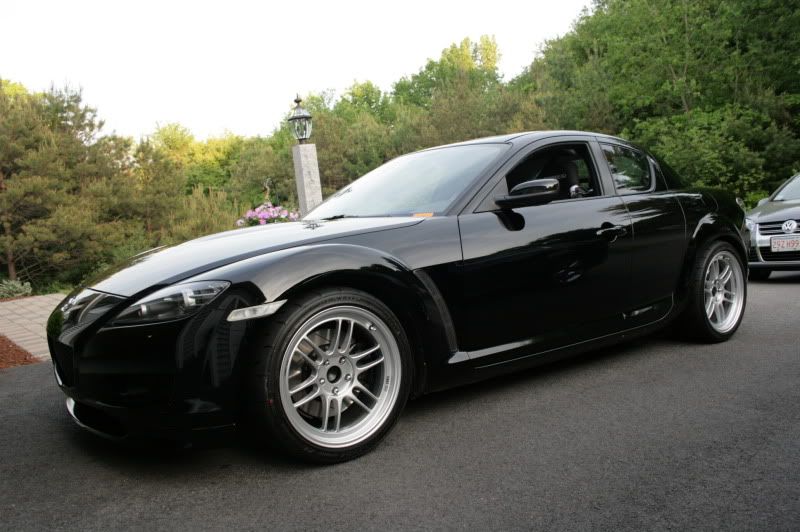

    Back Story: I had been helping my friend here and there with his 2004 Mazda RX-8 which he was using for autocross. After some discussion, I knew I wanted to be a bigger part of this and expand into a new venture for my business and myself. I decided to sponsor the '04 RX-8, dubbed "Midnight" by it's owner, my friend Marc. Being a previous owner of an RX-8, I also learned a great deal about the platform through my research and modifying and maintaining my own vehicle. Midnight had a challenging season, being in Street Mod versus some seriously built cars.
    Unfortunately, the dream and efforts of Midnight were short lived, as the vehicle was totaled in an accident in December 2010.
    Here is the information on "Midnight":

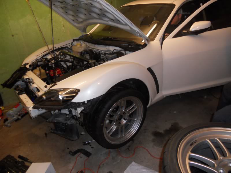

    A great deal of what was learned with building and competing with Midnight would be applied to our new project, "Serenity", a 2005 White Water Pearl Mazda RX-8 Sport. Our passion for the rotary engine, the research and development we have done, the connections we've made, and much more, has lead us to aim for another RX-8. Below is what we have planned for this build, which we plan to have completed very soon. So far, the results we have seen have been promising at local events.
    The Basics
    • 2005 White Water Pearl Mazda RX-8 Sport

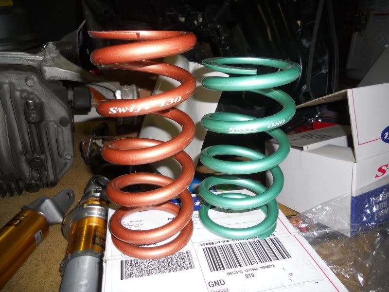

    • Front Springs 730lb. (13k)
    • Rear Springs 450lb. (8k)

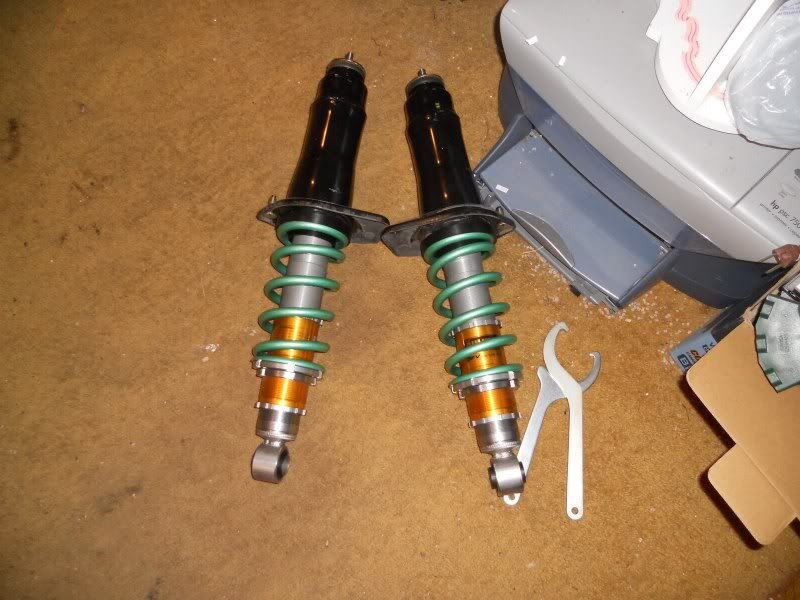

    • Custom-Valved Ohlin DFV Shocks with Swift Springs (NC Miata Rear Shocks)

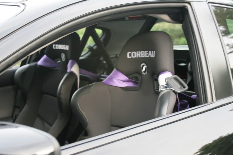

    • Corbeau FX1 Pro Fixed Back Seats (Black Cloth)
    • Corbeau 5-Point Camlock Harness Belt (Purple)
